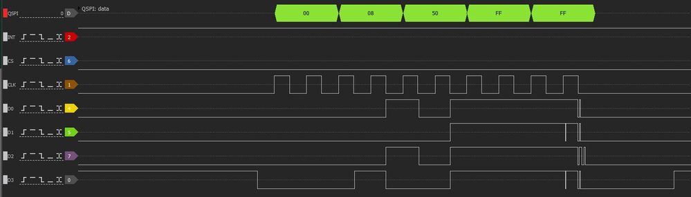

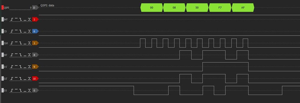

While reading the header (4 bytes) i see the first 2 bytes are correct always and the last 2 bytes as 0xFF's. If i take a capture directly from the QSPI pins on the slave i see correct values but as soon as i connect STM and capture on the STM QSPI lines it's all wrong.

Attached both valid and invalid captures for reference
