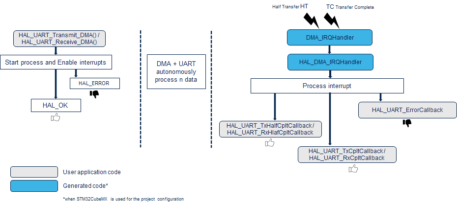

For the DMA mode, the UART half transfer callback or the transfer complete callback is called.
When DMA is used, the MX_DMA_Init shall always be called before any other HAL_***_Init (where *** is any peripheral with a HW dependency on DMA init code).
Make sure that :
Foued
