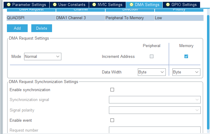

}I have DMA enabled in the Device Configuration Tool (DMA1 Channel 3, Peripheral to Memory, low priority, normal mode, synchronization and event disabled) with the QUADSPI global interrupt enabled, priority 5.

Also, these lines are created in the NVIC initialization code:
HAL_NVIC_SetPriority(DMA1_Channel3_IRQn, 5, 0);
HAL_NVIC_EnableIRQ(DMA1_Channel3_IRQn);Importantly, I've found that if I change the priority of 5 to anything less, then HAL_DMA_IRQHandler does get called.
