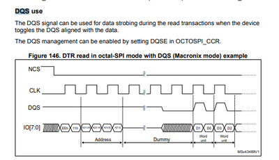

#define HAL_OSPI_MEMTYPE_HYPERBUS ((uint32_t)OCTOSPI_DCR1_MTYP_2) /*!< Hyperbus mode */from some forums its get to know that this is based on the data order D0/D1 or D1/D0 from the datasheet of my memory ship the timing diagram look like
so here what option i need to take. and planning to work with memory mapped mode . here when i tried with read and write my read and write is corrupting can anybody check with my configuration

The memory type depends on the D0/D1 ordering: The micron (and compatible memories) use D0/D1 Ordering while Macronix (and compatible memories) use D1/D0 data ordering and Macronix RAM (and compatible memories) use D1/D0 ordering with dedicated address mapping.
If you have a memory different from Micron and Macronix you simply need to look at the data ordering in the memory datasheet and then select the one that matches it in STM32 OSPI configuration.

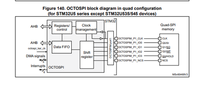

But, when using the QSPI mode, any memory type can be chosen if it is supported by the Octo-SPI interface. The memory type does not affect the functionality for the QSPI. The memory type has no impact in Quad-SPI mode.
Please take a look at AN5050 table8. and precisely note 2.

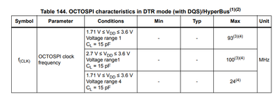

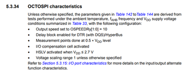

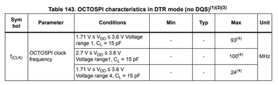

I recommend you to try to decrease the OCTOSPI frequency. Please take a look at DS13086 table143. and table 144. to check the maximum OCTOSPI frequency.

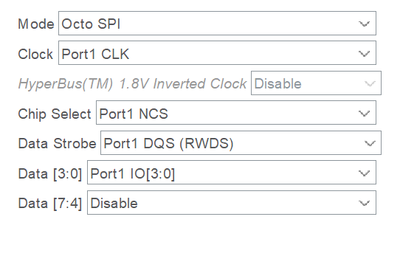

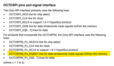

IS66WVQ2M4DALL is working on QSPI but it also uses the DQSM pin ,if we configured the OSPI in Quad mode in cubemx the DQSM pin option is not available so i am configuring it as OSPI and using the first IO pins only [IO3:0].
so am using the DQSM pin for the port1 for my purpose.

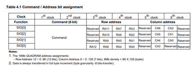

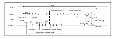

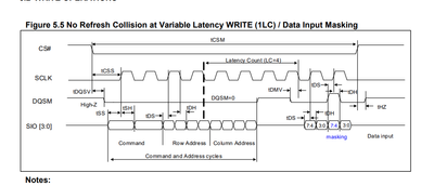

i checked the datasheet here the below diagram represents the write operation ,here the command is sent through 4 IO lines
one thing to note here am using the variable latency for the chip and the according to refresh collision the latency will change between LC/2LC(latency count configured in the configuration register) , and according to chip the refresh collision is detected by the DQSM pin.
but while looking through the reference manual of u585 i cant see the Collison detection functionality in DQSM uses

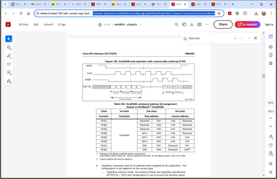

Check the datasheets for "Macronix" mode and "Macronix RAM" mode (you have tp configure this mode anyway and properly).
RM0456 mentions "your" address mode, page 1070:

yes like u said i need to configure macronix ram mode , but problem here is my device is working on qspi but user manual says this configuration is for macronix based octal ram , since its using 8 data lines in here it uses different assignment for the columns rows its fine .

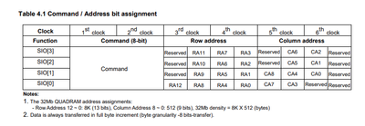

this is my QSPI based address assignment according to ISSI data sheet
here we can clearly sees that the column address will be a problem for me when comparing the both cases .and when i compare other ISSI based octal rams the address assignment matches perfectly with reference manual diagram.
and from ST side no information is available on the address assignment in QSPI mode. now am in difficult situation since my team already prepared some proto boards with this IC. i don't know weather i need to go with another proto by changing the IC with some other.

Have you tried to configure Maxcronix RAM in QuadSPI mode and checked with a scope if QSPI bus looks reasonable?
Yes, it is mentioned as an example, DTR mode and Octal. But I would assume it works also in Quad mode. And this data word flip (in DTR mode) is not important (for using as RAM, and sounds like just for Octal mode).
Have you seen this? This might give you a clue or it will even support QuadSPI:
https://github.com/STMicroelectronics/stm32-iss66wvh8m8
Even it is not directly mentioned as QuadSPI in RM, this row and column, just as Quad example. I think, "Macronix RAM" mode means this Rows and Columns, independent if Octal or Quad.
Why should Maxronix RAM in Quad mode not work? (it might just not being given as an example: configure it, test it with a scope...).

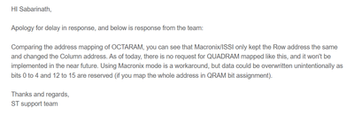

2025-02-17 9:20 PM
hi
i tried with macronix_ram mode there the entire data is corrupting. but when i configure on regular macronix mode and tried to write and read from the particular addresses its working fine ( addresses - 0x90000000,0x90000020,0x90000040...etc. manually translating the address according the datasheet of the chip).
when i contacted the chip vender they given me this replay
i also don't know why ST is not take caring of the QSPI macronix ram based address formatting even if they support same macronix ram based OSPI address format.
thanks for your time .
