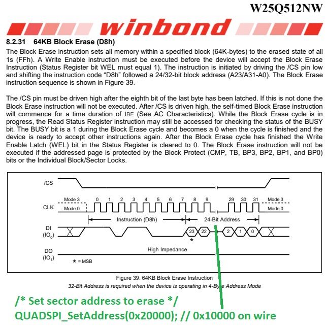

In "DUAL" mode both devices need to be the same, content is multiplexed at a BYTE level. So all send and receive commands are sent to both devices and the data sent and received alternates between them.
The command and address goes to both devices in parallel. The address is divided by TWO
Pages that were 0x100 or 0x1000 will now be 0x200 or 0x2000, see also addresses for erase, etc.
The status comes back in pairs, and devices might not be synchronized, ie one might complete the erase before the other, you need to wait for BOTH to complete fully.
To erase the second 64KB block in both devices (0x10000 on a single device), you pass the 0x20000 address, and it will erase 128KB across both devices.

2023-08-11 10:02 AM - edited 2023-08-11 10:18 AM
The QSPI peripheral does the address division, so the address you pass as a parameter is divided by 2 on the wire, A0 would then select one device or the other, although I wouldn't rely on that. Do everything with the expectation that both devices are involved.
As per my example you set Address = 0x20000, the devices see 0x10000 on the wire.
BTW 0x1000 / 2 = 0x800
