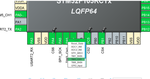

I want to generate 6 PWMs using channel 1 of timers 1,8,2,3,4,5. All of them are set the same way except ARR, PSC and CCR1 registers. However, it turned out that timers 2 and 3 don't have PWM signal on their pins. The content of registers for those timers are the same (checked during debugging). I also tried to initialize timers by writing directly to registers, with no luck. MCU: STM32F103RCT6. Here is the the initialization for timer 3, for example:

TIM3->CR1 |= TIM_CR1_CEN; // PWM onI tried another STM32F103RCT6, but behaviour is the same. Is that hardware issue inside the MCU?
2024-12-26 12:28 AM
Unlike every other STM32, the 'F1 GPIO is not flexible, and you cannot have multiple peripherals which map to the same pin enabled at the same time.
Here, the conflict is probably with SPI1.

2024-12-25 10:26 AM - edited 2024-12-25 10:27 AM
Hello Sarra,
If I set up TIM3 using CubeMX, should not it be remapped by default?
2024-12-26 12:28 AM
2025-01-16 6:46 AM
I disabled SPI and it worked. Thank you very much for your help! CubeMX seems confusing in that sense because it does not indicate any conflict when I enable SPI in transmit-only mode and want to use MISO pin for different purpose. Is that property of F1 series stated somewhere in datasheet or RM, so I can read about it?
