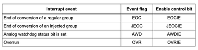

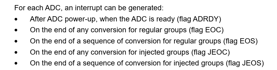

depends on your selection, what ISR you want/need:
2024-04-01 7:18 AM
There is no EOS flag!

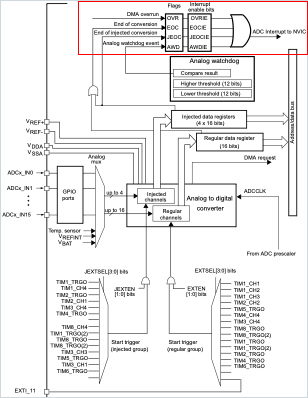

From the ADC block diagram
But, the End of Conversion (EOC) flag (in ADC_SR reg) can be triggered at the end of each conversion or at the end of a sequence, depending on the EOCS bit (in ADC_CR2 reg)
