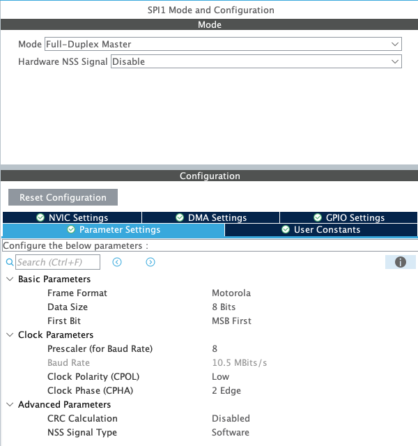

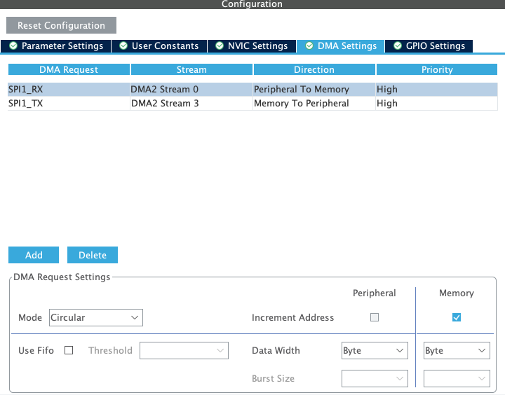

My SPI is configured like so:

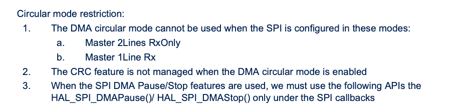

The HAL Reference Manual notes:
To try to sidestep issue #1 with my SSI setup here, I do this in my code to start the circular DMA:

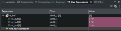

}Then I enter the debugger and monitor rx_buf:
Gif compression aside (the values change more rapidly than what is seen here), this doesn't look like meaningful information to me - the values only switch between 0 and 255, e.g.
I wonder if it is relevant to highlight that I'm doing this from within a freeRTOS task? rx_buf is currently declared a global within one of my tasks. It feels as though I am making a mistake with correctly writing to a memory location or something, but this is where I'm bumping up against my inexperience.

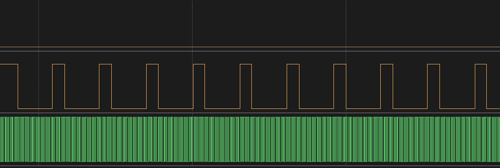

Have you tried to use SPI without DMA?
Or even bit-bang the interface, if the slave supports slow clocks?
Have you observed the signals on the pins?
2025-01-15 8:44 AM

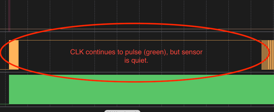

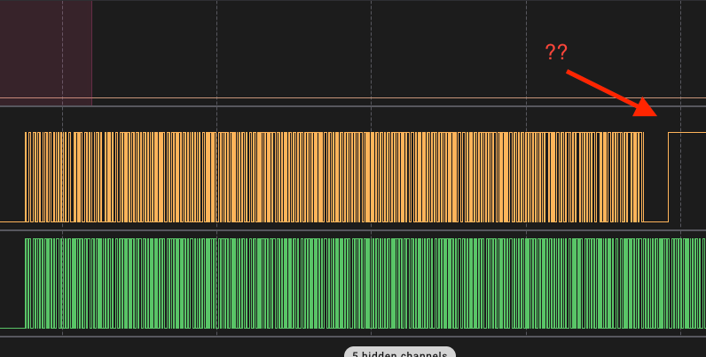

Oh good question, thanks - I think this led me to a great clue!
It seems to stay in this state for a bit:

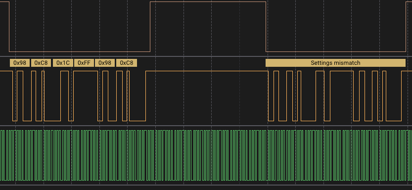

Then finally starts pulsing what I'm guessing is an error signal:
All of this led me to realize that I never pull CS High again after each individual transaction (which is what I do when reading the sensor in a polling fashion). From Page 23 of the sensor's datasheet:
"The MT6701 SSI is shown in Figure 24, a data transfer starts when CSN is pulled to logic ‘Low’. The MT6701 transfers data on the falling edge of CLK, and the data transfer finally stops when CSN is pulled to logic ‘High’"

}This kinda-sorta seems to work - when viewing my angle variable in the debugger, I see it now reporting meaningful, reasonable values. Except, it seems kind of "stuttery" - it sort of returns a few good values, then hangs for a while (seemingly), then returns more values, hangs, etc.

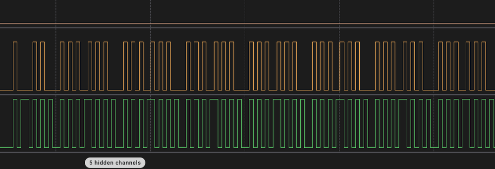

When inspecting things now with a logic probe, I see this:
I wonder if what's happening now is that things are no longer properly synchronized - it looks like the SPI clock continues to run separately from me yanking CS high or low.
Stepping back: I wanted to try digging into this to learn, but am I choosing a poor test case for circular DMA? I can't tell if I'm using this as it was intended to be used or if I'm just inadvertently creating a bigger problem for myself.
2025-01-16 8:20 AM
Yes you probably are.
Framing SPI transfers by signals like chip-select/slave-select/load/whateverisitcalled is - quite logically - a repeating theme here. The usual solution is just to perform the transactions using polling/interrupts/DMA, and "manually" toggle the CS pin.
If you'd want automation, one of the solutions would be to generate both the SCK clock and the framing signal using timers, and feed them back externally from TIM pins to SPI pins, running the SPI as slave. Another option is to use SPI as usually, and feed the SPI data register (i.e. Tx, which determines the clocks) from a DMA driven by a timer, from which a slave timer derives the framing signal. There may be other options, too, but only rarely offer any of these any significant benefit over the "manual" solution.
