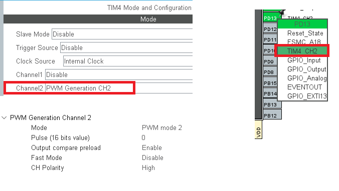

2023-05-31 11:57 AM - edited 2023-11-20 4:17 AM
STM32F407
There are only two lines in the code that I wrote.
HAL_TIM_PWM_Start(&htim4, TIM_CHANNEL_2);
TIM4->CCR2=3;
The pin is activated when the number in the CNT register and the CCR2 register match.
The pin is deactivated at the end of counting in the CNT register.
Where can I find in the code what causes this behavior?
In the code, I did not find a mention of the GPIOD PIN 13 pin.
Interrupts are disabled.
In the Out Compare CH2 mode, the pin is not activated without writing a code to activate the pin.
2023-05-31 12:09 PM
Often this is handled in the MSP files.
Initialize clocks, pins and peripherals. Selects the AF (Alternate Function) via mux settings in the pin initialization. Refer to Data Sheet for STM32 part in question.
Suggest Find-in-Files "HAL_GPIO_Init(" or "GPIO_PIN_13"
2023-05-31 12:51 PM
The stm32f4xx_hal_msp.c file contains the initialization of pin 13.
But there is no pin activation and deactivation in this file.

2023-05-31 12:57 PM
The TIM *hardware* has counters and comparators, it's those that drive the pin high and low, it's not done in software.
Perhaps look at the Reference Manual, and the block diagrams of the TIM units.
The gate level portion of the design is not expressed in the materials available to you.
