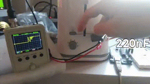

2021-08-23 1:26 AM
You can always add a capacitor in pararell with your input to debounce your signal. (harware low pass filter).
I used 220nF because it was a very strong mechanical bounce, you should try 10nF and maybe also a series resistance.
