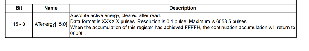

For KWH calculation, I am reading Absolute active energy register for kwh values. In the datasheet they mentioned the values I receive from the energy register are pulses.
how can I convert pulses to kwh. can anyone suggest?
my pulse constant value is 1000 imp/kwh.
From the datasheet they mentioned register will be cleared after read.

@sireevenkat1 wrote:
So that's telling you that the number in the register is in units of 0.1 pulse;
eg, if the register value is 65535, that represent 65535 * 0.1 pulses = 6553.5 pulses.
As we've already established, 1 pulse represents 1 kWh - so 6553.5 pulses represent 6553.5 kWh.
