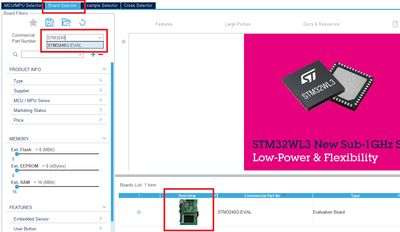

In CubeMx, do your selection based on the board and not on the MCU. Follow the steps in this figure:

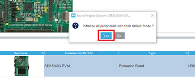

Then in "3" double click on the board image. A Popup message will show up telling you if you need to initialize the peripherals used on the board to their default values. Click "Yes":
Normally all the peripherals used on the board are initialized including the FMC and the GPIOs related to the external SRAM.
