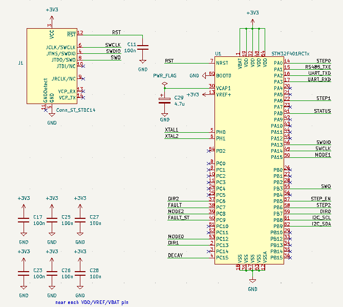

I am quite new from working with STM32 products but recently made the switch from Atmel chips (thanks to the free handout of Nucleo boards at the Eurobot competition I guess :) ). I recently designed a fairly simple board, centered around a STM32F401 chip. The schematics is fairly simple. Here is the MCU part of the schematics (power supply and application circuits aside):
In addition to this custom board, I purchased a ST-Link V3-MINIE programmer board, which connects onto the STDC14 connector for programming and debugging the microcontroller.
My question is about the NRST pin. As explained in the datasheet and the application notes, there is supposed to be a pull-up resistor internal to the chip, so the datasheet recommends only a 0.1uF resistor between NRST and GND. However, I can't make the board work that way: the STM32CubeProgrammer application can recognize the chip, but any flashing attempt fails with a "dev_target_held_under_reset" error, which is self-explanatory.
I thus added a 1k pull-up to 3.3V on the NRST line, and now my board works fine. How come? Did I miss something?

@Tesla DeLorean wrote:There's a pull-up internally on the NRST that should suffice.
Thanks for your reply. However, it seems that on my board, this was not the case, which surprised me (and the result is a board that cannot boot without rework). What could possibly cause the line to remain low?

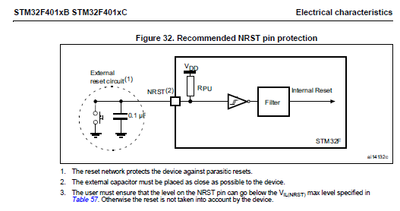

Looking at the datasheet. for the STM32F401 Paragraph 6.3.17 NRST pin characteristics Figure 32 shows just a capacitor.
They say the pullup is between 30K and 50K which is not very much current. 0.66 uA to 11 uA.

According to STM32 data sheets there is no need to connect anything to the NRST pin - no capacitor, no resistor. The capacitor could be useful if the NRST pin is routed to a distant connector (like 20 cm long track/wire). None of my PCBs designed in the last 7 years has NRST pin connected - there is no need for such connection.
And "It is because I do it with other processors." is simply funny. The "other processors" (like old 8051) did not contain the built-in reset circuitry like most of modern ones.
2023-07-08 5:19 PM
@gbm The datasheet recommends a 0.1uF capacitor to avoid spurious resets.

Fortunately it was only a prototype so I could go forward by hand soldering a 10k resistor and reordered another prototype with the pullup on the reset line. This is an easy fix. I asked the question here because the behavior I observe is quite unexpected, TDK posted the datasheet and there is supposed to be an internal pullup.
Your hypothesis makes sense, but still, beating a 50k pullup is much leakage current.
