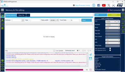

I've tried many times with different times between resetting my target and trying to connect with the programmer, but no success. I hope a capture of the serial port will help diagnose the problem, so I've attached both an ASCII view of a failed attempt and its hex view (from the same connection attempt).
Please take a look at the yellow-highlighted areas in both images. A 0x7F is sent, and the response is 0x7F 0x1B, followed by another 0x7F being sent. The programmer's log shows:
17:57:25 : RTS low
17:57:25 : DTR Low
17:57:25 : Serial Port COM6 is successfully opened.
17:57:25 : Port configuration: parity = even, baudrate = 115200, data-bit = 8, stop-bit = 1.0, flow-control = off
17:57:25 : Error: Activating device: KO. Please, verify the boot mode configuration and check the serial port configuration. Reset your device then try again...
17:57:36 : RTS low
17:57:36 : DTR Low
17:57:36 : Serial Port COM6 is successfully opened.
17:57:36 : Port configuration: parity = even, baudrate = 115200, data-bit = 8, stop-bit = 1.0, flow-control = off
17:57:36 : Error: Activating device: KO. Please, verify the boot mode configuration and check the serial port configuration. Reset your device then try again...
The Programmer window look like this:
