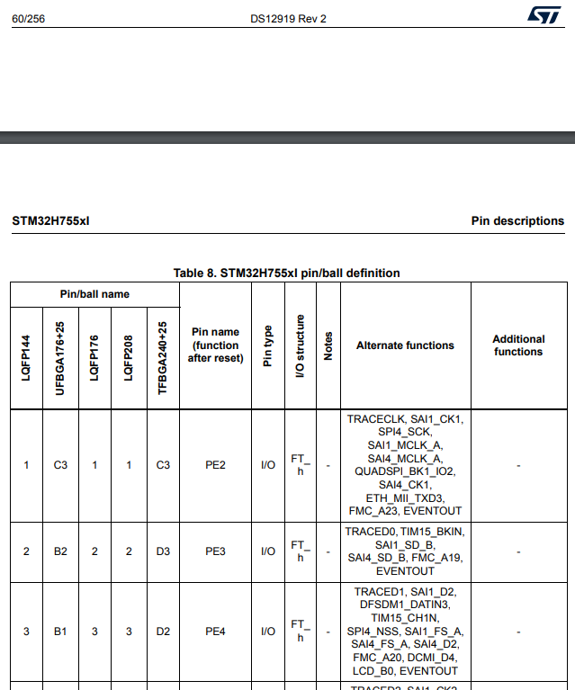

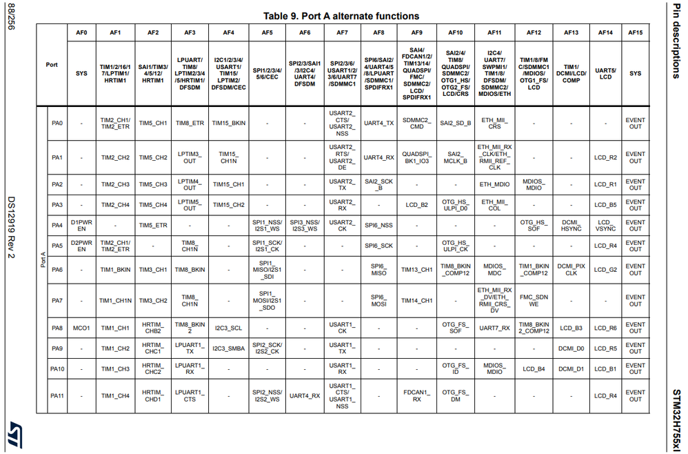

2025-02-17 4:25 PM
The Datasheet has a table which tells you what alternate functions are mapped to each pin.
For the case of STM32H755ZIT:
https://www.st.com/resource/en/datasheet/stm32h755zi.pdf#page=61
For how to select each Alternate Function, see:

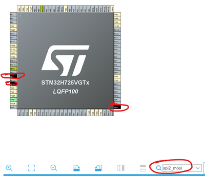

2025-02-17 4:21 PM
Two ways:
On the bottom right, you can search pins by function. Typing in "SPI2_MOSI" will have all pins that can be configured as that flash. Typing in "SPI2" will flash all pins with an SPI2 function.

2025-02-17 4:25 PM
