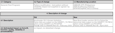

We have recently come across this PCN where Bootloader version of 9.1 is Changed to V9.2 resolving abnormal data output on the USART1_TX PB14.
  1. We are using USART3_TX on PB14 and USART3_RX on PB11.  Do you think OPC bootloader V9.1 to V9.2 has any impact on USART 3 interface used for RS-232 ?

Amel NASRI
Hi @richaverma ,
Welcome to our Community!
First recommendation I share is to check the bootloader version for both batch of devices.
Depending on the bootloader version, you may confirm or discard some assumptions.
Your reference is AN2606: depending on the version, please check the table "Table 124. STM32H74xxx/75xxx bootloader version" for the known limitations (mainly what is related to USART1 pins in your case).
Please keep me informed about the outcomes of your checks.
-Amel
