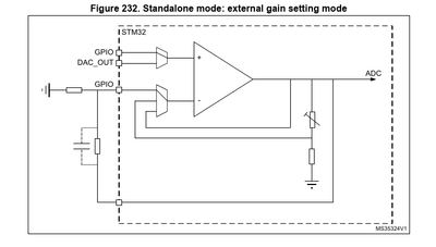

See in rm opamp :
So you could add all circuit you need for biasing etc external and it should work as expected.
But use up 3 pins to get an opamp with some 3mV offset and about 1000nV/(sqrt Hz ) - no big player for low level signals. :)

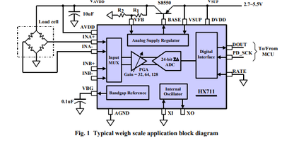

For low level like Strain Gauge Wheatstone bridge i would add a typical chip for such use, like HX711:
24bit ADC , with bridge PGA input , about 50nV total noise (!) ->
+ about 2 $ investment...

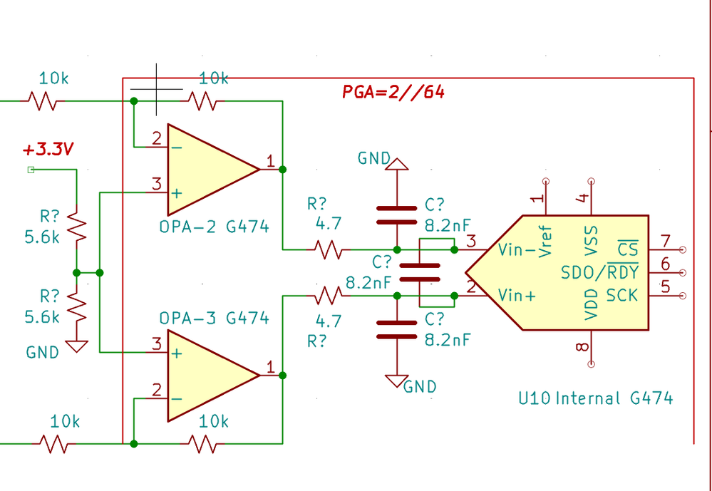

If OPA's all 3 pins are accessible , than combine two OPA.
Circuits successfully implemented in one of my projects with nucleo-G474re.
*resistors 10k - internal PGA matrix.

If G4 is too large, than ads1292 is small? Have you compare footprint?

Well, 12-bits + PGA x2 x64 => 7-bits = 19-bits total.
If power consumption isn't an obstacle, I'd run adc at 2.5 msps and "crunch" 5+ bits more, getting close to 24 total.
Running adc at max speed provides one more advantage, reducing noise of the OPA over wide band, so 250 nV (datasheet G4) mostly nulled-out,
The ADC native resolution is still 12-bits no matter how much you amplify the signal, or use oversampling techniques.
I think the G4 solution is worth a test though as @MasterT  describes above
I have a dev board so will see if configuring 2 Op-Amps into a single Instrumentation Amp, then using 2 ADC channels in Diff mode provides an adequate solution.  If it saves me the space and hassle of adding an External ADC.
