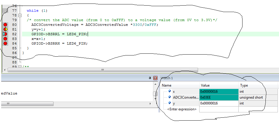

I bought a development board STM32F4 discovery. I wanted to try the debug and I modified the example ADC3_DMA in STM32F4-Discovery_FW_V1.1.0 in this mode:/**

has someone already had a similar problem? and can give me suggestions?

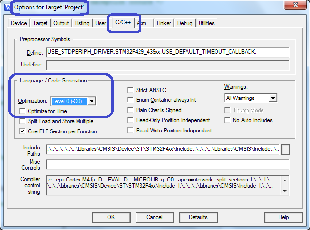

Turn OFF optimization.
2013-11-10 8:11 AM
Thanks Clive1 but I don't understand, what is the turn off optimization?
2013-11-10 8:54 AM
In order to see linear and simplified code flow you need to turn optimization off so that the compiler does not reorganize your code. Alternatively you can look at the disassembly window and the flow of the instructions generated, but don't always expect line level equivalence. Instead of breakpointing everything use the step in, step over, step out buttons.
2013-11-10 10:27 AM
Thanks Clive1. now work correctly.
