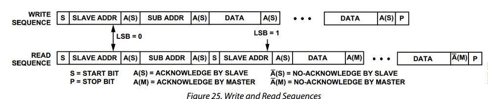

This is part of the AD7746 datasheet that explains write and read:
So for reading one byte of capacitance or temperature data you must first send start bit, write 0x90, and then write the address again, send start bit, write 0x91 and then read data but I get 6 similar data.

In datasheet mention if stop occur, address set to 0x00
but in HAL I changed the address from 1 to 6 in this code but all 6 data are similar
