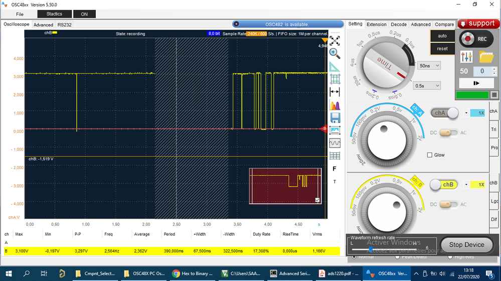

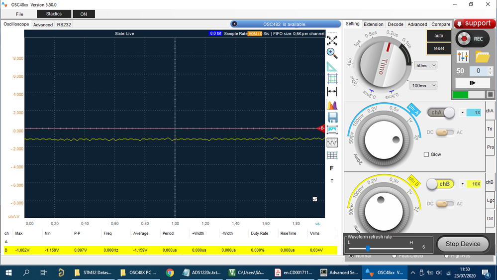

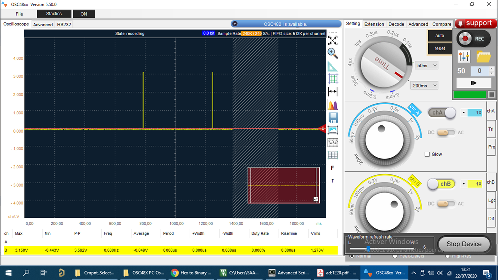

i have a problem with SPI slave device, it doesn't receive the clock signal from stm32f103 (Master), i have configured the baud rate correctly : 72Mhz/32 (SPI1), which is inside the range clock freq of slave device, CS pin is active low so when i send a command i set CS = 1(low), i have checked many parameters but i still have nothing in clk clock, MOSI , MISO line are ok, as shown in these pictures below, please if anyone has any suggestion ! this is the SPI1 config code

If MISO is okay, your clock must be making it there. Otherwise the device would not be responding.
