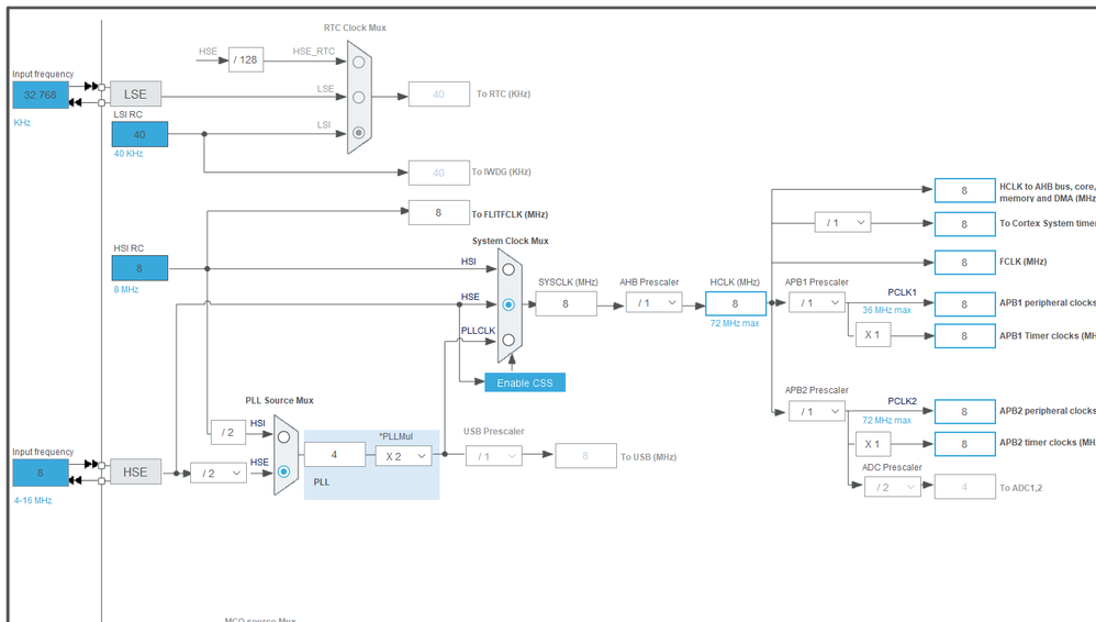

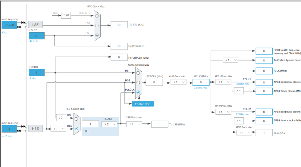

I want to recieve two SPI signals sharing the same Enable Line, e.g. having exactly the same speed. I record them using the HAL_SPI_Receive_DMA function and count how many times SPI1 and SPI2 filled there respective Buffers.
When using HSI or HSE in system clock mux no problem occures.
When using PLLCLK the number of completed Buffers diverges dramaticly.
Problem is i need to use PLL for activating USB capabilitys
this example does not work
this example works perfectly
code NOT working:

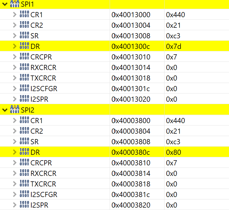

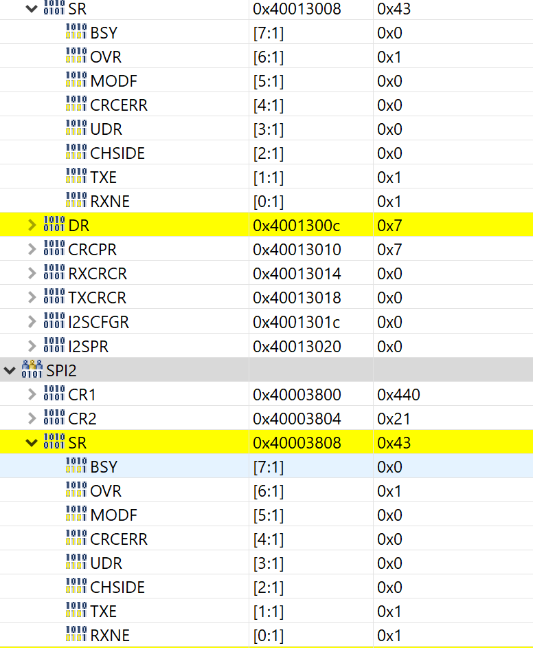

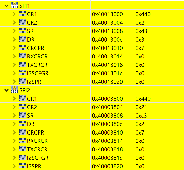

Can you post the contents of the SPI peripheral registers both in the working and non-working case?
2020-04-24 8:21 AM
Ja sure:
Works:
broken:
2020-04-24 8:23 AM
the only difference in SR betwen 0x43 and 0xc3 is the BSY flag
