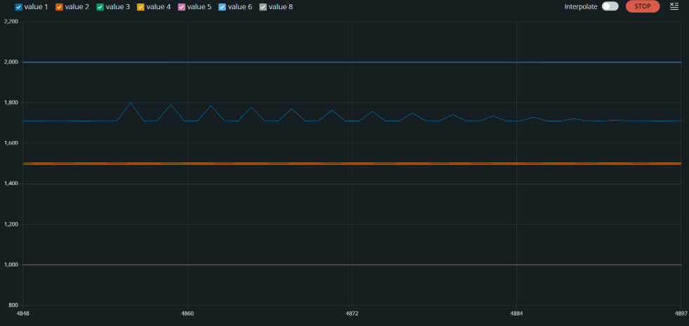

The spikes looks like that (Thrust channel in blue):
The spikes are really high at the beginning, and they start to slow down and eventually disappear for some time, before coming back again.

Using input capture won't be susceptible to cpu load based delays like manual counting and capturing will be.
Your graph showed some pulses. Are you calling those spikes? Or did i look at the wrong graph?
2025-01-27 4:04 AM
Thank you for your answer, Carl_G.
Yes, I believe "pulses" is a better word than "spikes". On the graph, you can count approximately ~12-13 pulses on the blue curve.
My first intuition was that the line below in my callbacks:
__HAL_TIM_GET_COUNTER(&htim1);was still counting a little bit more (causing the pulse) during the activation of another unknown callback with a higher priority than my own PWM counting callback. The pulses happens approximately every 20 seconds. There is sometime only one pulse, sometime 6, sometime more...

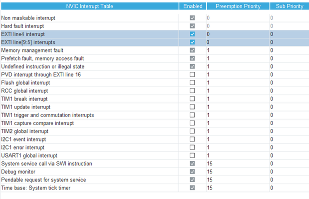

I increased the priority of my 2 EXTI channels and decreased the others, and I still have the same problem.
2025-01-28 7:49 PM
Seems then maybe they are interfering with each other. What if edges happen at the same time? Will the function be called multiple times or will one of the triggers be lost? What's the calling function look like?
