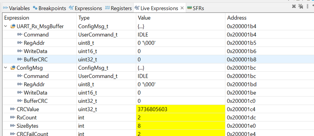

The image below shows the Live Expressions window:
I'm experiencing an issue where the UART reception seems to split the incoming data into multiple callbacks, even though the data is being sent in a single transmission. Specifically:
My questions are:
Any insights or suggestions on how to properly configure the UART to avoid this issue would be greatly appreciated!

Although disabling the HT callback works to some extent, it is still unclear to me why the HAL_UARTEx_RxEventCallback is called multiple times, even though the data is being transmitted only once from PySerial. Additionally, I am unable to clear the UART_Rx_MsgBuffer before receiving new data. I would appreciate your advice and clarification on these issues.
