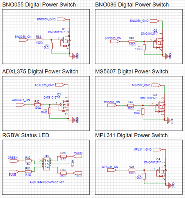

I want to use some MOSFETS to individually power up/down sensors on a PCB. Here's the schematics :
The MOSFET is a DMG1012T-7 (N-Channel) and here's it's datasheet :
https://www.lcsc.com/datasheet/lcsc_datasheet_1809050424_Diodes-Incorporated-DMG1012T-7_C20512.pdf
All the sensors runs on 3.3V and the maximum power draw for a single sensor is 14.34 mA max.
What do you think about this? Is it a good practice ?
2024-09-03 4:36 AM
I think I made a huge mistake! As they are N-Channel MOSFETS, they're supposed to switch the "low side" of a load. So the previous schematics are totally wrong..
Here's the correction :
