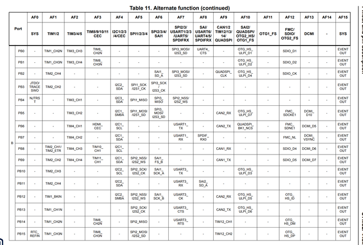

PS by the way, i there some documentation of how the can pins should be wired in a typical situation? Reason why i ask is because PB5/PB13 is not a normal CAN pin combination. PB5 is part of an alternate config, while PB13 is part of the standard config.

AF9 )
