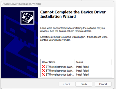

So, I have downloaded the en.stsw-link009 and I have launched dpinst_amd64.exe, with the board connected, but I receive this window.

Best guess is some antivirus software or "protection" software is preventing driver installation.
Can STM32CubeProgrammer install successfully? And can it connect to the board? It should install drivers as well.

I can't to install stm 32cube programmer because I'm not the pc-administrator..
Maybe this is the problem
2024-07-16 1:28 PM - edited 2024-07-16 4:47 PM
Yes maybe installing drivers failed because it could not elevate.
Please look in c:\windows\dpinst.log and \windows\INF\setupapi.dev*.log (most recent files)
