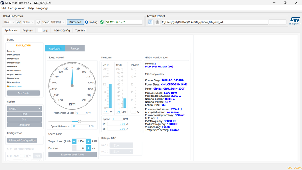

Good evening, I am trying to use a P-NUCLEO-IHM03 pack.
I have generated the project using the X-CUBE-MCSDK version 6.4.2 and STM32cubeMX version 6.17.0, built and flashed the project on the board. The problem is that as soon as I try to start the motor in ST motor pilot, I get a driver protection fault instantly, without any movements of the motor:

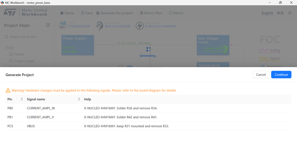

I didn't touch any configuration and jumper of the board, but while I generate the project I get these warnings (I don't know if this coukd be the reason of the fault):

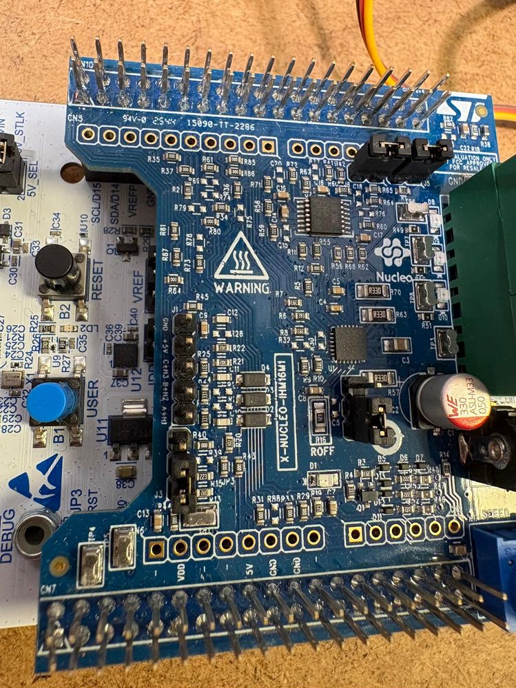

Hello @giulioTam,
Verify that both boards are connected correctly.
Refer to section 4.1 operation mode and sensing topology selection in the X-NUCLEO-IHM16M1 user manual for FOC 3-shunt board settings.
Warning messages relate to X-NUCLEO-IHM16M1 signal connections. For more details, refer to the board schematic available in the user manual. These warning messages can be ignored in the P-NUCLEO-IHM03 use case.
