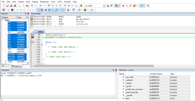

Yes, looks like it is still calling/expecting the semihosting.
Are you using the Keil _ttywrch() / fputc() implementation, or the GNU/GCC _write() ones? Likely going to depend on the libraries / syscalls pulled in.. Suggest you look at the .MAP or get a disassembly / analysis via FROMELF tool.

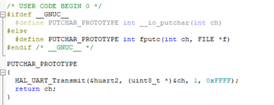

I am using fputc() implementation.
