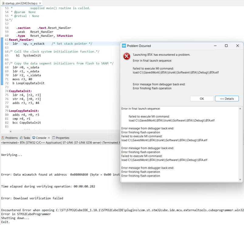

I flashed the software to the Nucleo-L433RC-P board, but I am getting strange and random issues.
It seemed to work to start with, but after several further flashes it stopped working with the error shown below...
I'm not sure but it seems to go to a reset handler in "startup_stm32l433rctxp.s"....
The console shows the following error...

Error: Data mismatch found at address 0x0800A860 (byte = 0x00 instead of 0x2E)
Time elapsed during verifying operation: 00:00:00.284
Error: Download verification failed
Encountered Error when opening C:\ST\STM32CubeIDE_1.18.1\STM32CubeIDE\plugins\com.st.stm32cube.ide.mcu.externaltools.cubeprogrammer.win32_2.2.200.202503041107\tools\bin\STM32_Programmer_CLI.exe
Error in STM32CubeProgrammer
Shutting down...
Exit.
When I tried again later in the day, it started working again but then it stopped after several flashes.

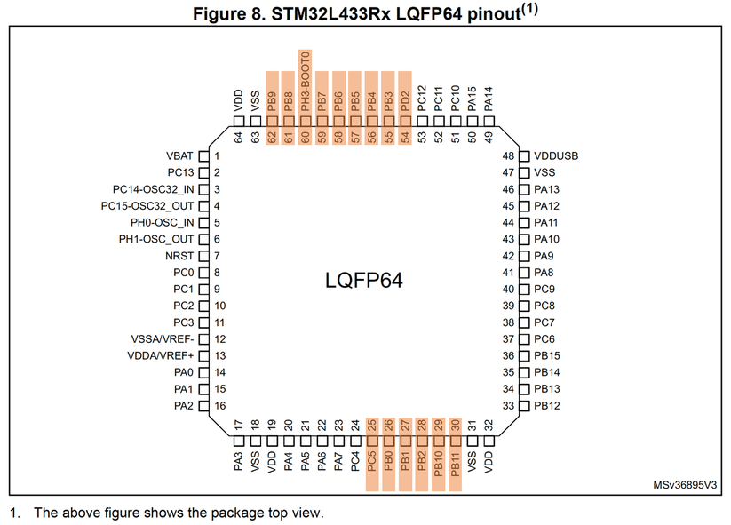

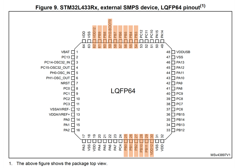

The difference in the pin out between the STM32L433RCT6P and STM32L433RCT6 MCU is highlighted in orange below...
STM32L433RCT6....
STM32L433RCT6P

Thanks both, but something is not right.
I created a clean, new project for the Nucleo-L433RC-P board but when I try to flash the software I still get the same error.
Its as if flashing with the non-SMPS software has damaged the board, but I cant see how and would be surprised if this were the case.
Why am I unable to flash software to the Nucleo-L433RC-P board, even though I am now using the correct software (i.e. targeted for STM32L433RCT6P) designed for this board ?
