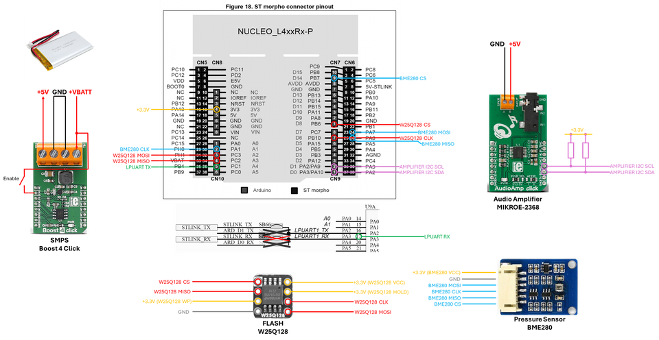

Below is my setup...

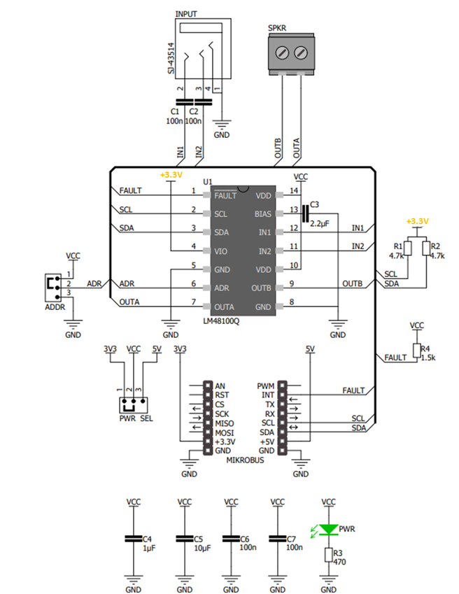

For example, the audio amplifier is powered by the 5V SMPS, but even when the SMPS is disabled, the +3.3V from the Nucleo-L433RC-P board (which is used for I2CVDD pin and IC2 pull up resistors) seems to somehow power the amplifier (LED on and audio plays).
Why am I having such difficulty flashing and debugging and how to I resolve it ?
Is the Nucleo-L433RC-P board damaged or are my interface boards causing an issue ?

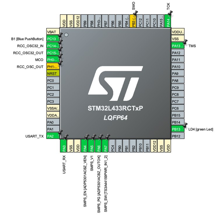

A clean project for the Nucleo-L433RC-P board uses the following pin out...

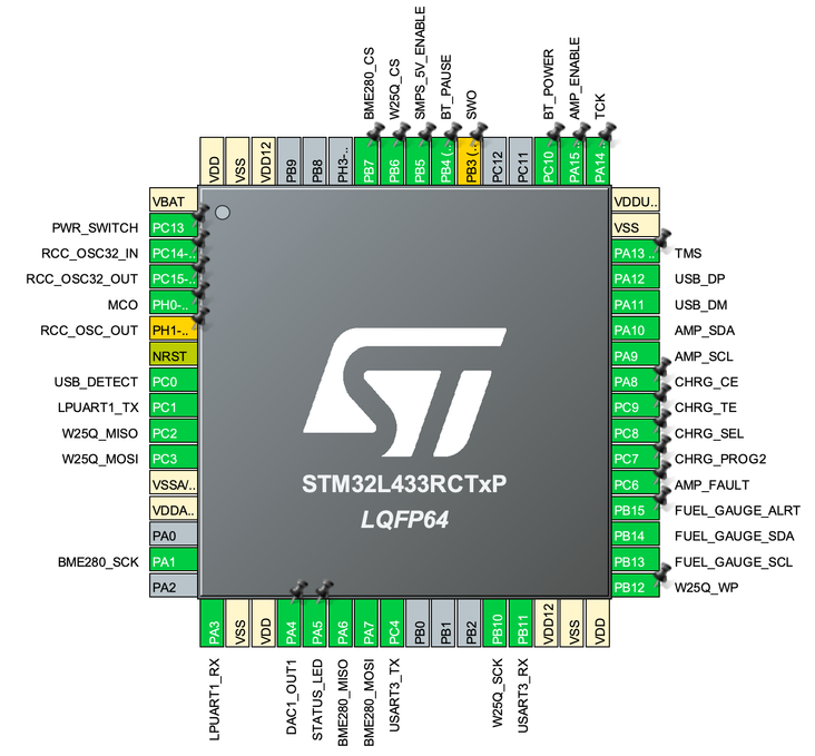

But my project does not use the external SMPS and I have re-assigned the pins:
Could these changes have caused any damage ?
Because it still doesnt flash or debug even if I swtich to a clean project for the Nucleo-L433RC-P board
