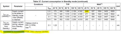

Without RTC the figures would be within the limits, yes.
But with RTC (datasheet figures):
Standby with LSE low drive: 281 nA (no max value specified)
SRAM2 max consumption: 249 nA
That's 530nA in total. I'm measuring between 590 and 600 nA.
2023-07-09 8:45 AM
Hi @ramses946 ,
We can not guarantee the maximum values on LSE tests because of the hardware constraints in production.
This is why we don't have in datasheet the maximum values for the Standby with LSE in low drive mode.
I think the over 60nA - 70nA that you are measuring are due to sample variation.
Best regards,
Aime

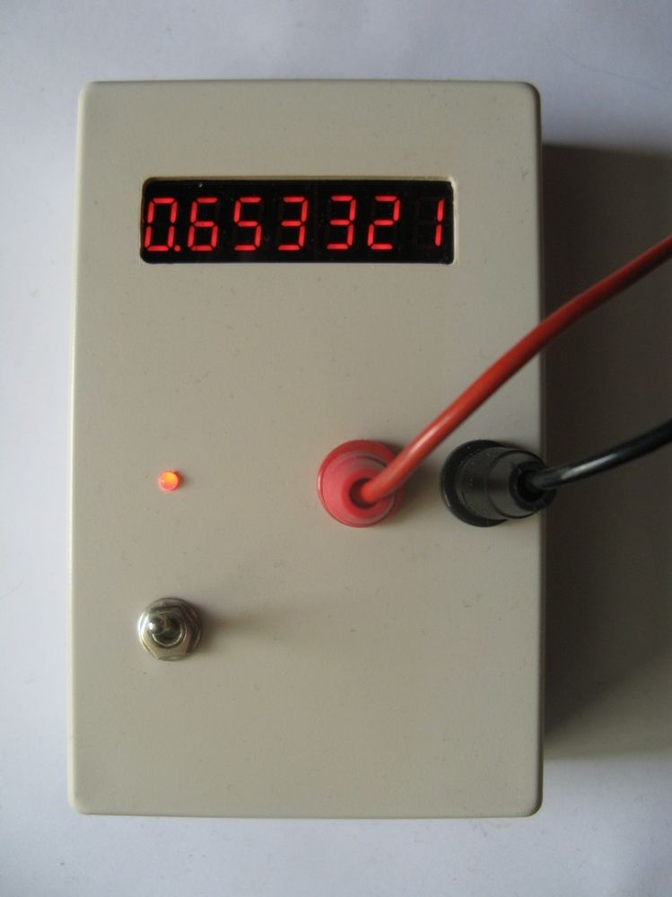

About frequency measurement, it might be interesting to see this project, maybe using a TCXO of 0.1 PPM is better than common crystals:
https://www.instructables.com/High-Resolution-Frequency-Counter/
