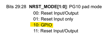

Yes, on the STM32G4 series you can set the NRST_MODE option byte to 10 so the PG10/NRST pin functions only as a GPIO.

Thank you for the suggestion! I had forgotten about the option of changing the pin function in software. Is this possible to do via SWD (without having a running program)? The problem I'm trying to solve is performing the initial programming without splitting the program into a small loader (which can be programmed fast enough to avoid reset and then refresh the watchdog IC while it programs the application section).

Yes, you can change the option bytes using STM32CubeProgrammer in the OB tab. Ther is also a command-line version of STM32CubeProgrammer that you could use. SWD will connect if no program is loaded.
