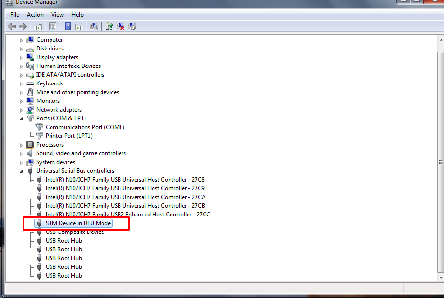

when i connect this module its showing in device manages as "STM device in DFU mode".
I followed some steps from here but its not working...

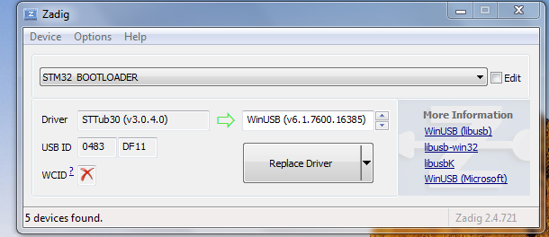

In Zadig software its showing as "STM32 BOOTLOADER"
I intalled WINUSB(libusb) dirver in it through Zadig only. installed successfully.

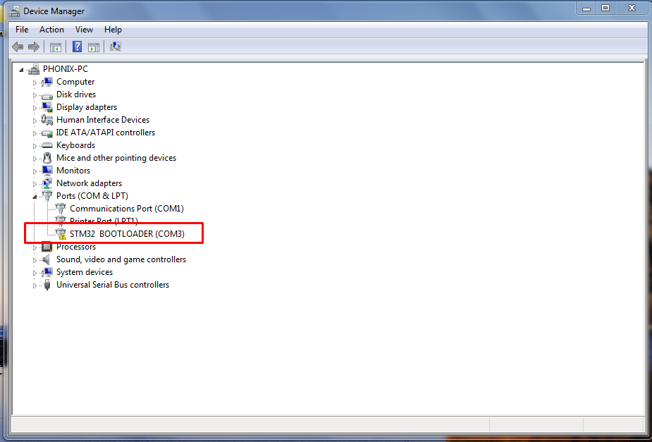

then its showing like following in device manager..

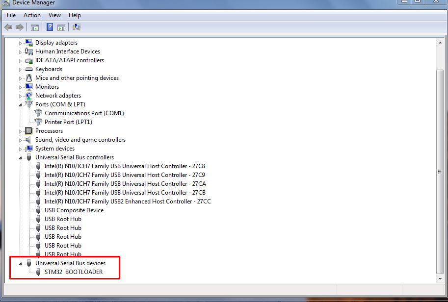

i unistalled this drivers and upload WINUSB(Microsoft) dirver in it through Zadig only. installed successfully.

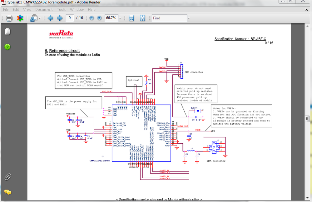

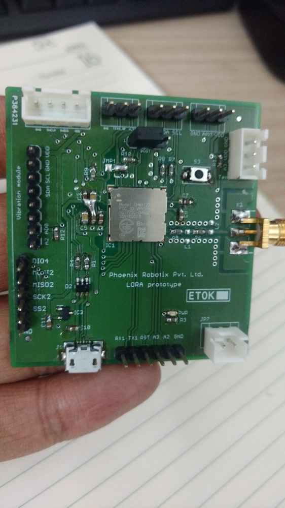

we made one customized board using following reference circuit from module datasheet
Our board is looking like this
link of product and datasheet
https://www.murata.com/en-sg/products/lpwa/lora#lora3

Your board schematic would have been more helpful than Murata's.
Check what you have actually built.
Make sure BOOT0 is in fact pulled LOW, because the behaviour suggests it is not.
Test the SWD debug interface. Compile, download and debug code in Keil, look at the state of the processor. Check what code is executing.
