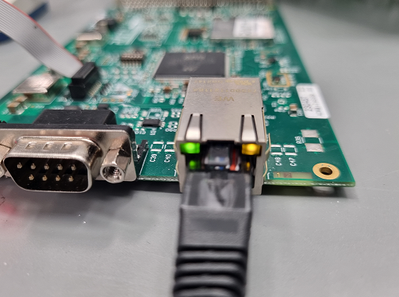

I connected an ethernet cable to the board, the link status LEDs light up well, but I can't ping the board's IP.
