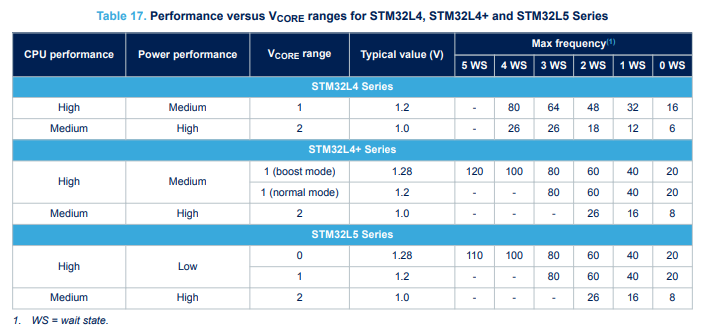

The following table that you may find in AN5138 (Migrating from STM32L4 and STM32L4+ to STM32L5 Series microcontrollers) summarizes the differences:
0693W000006GtktQAC.pngIn order to more enhance the performance for your STM32L5 device, I recommend you to refer to the application note AN5212 (Using STM32L5 Series cache to optimize performance and power efficiency).
