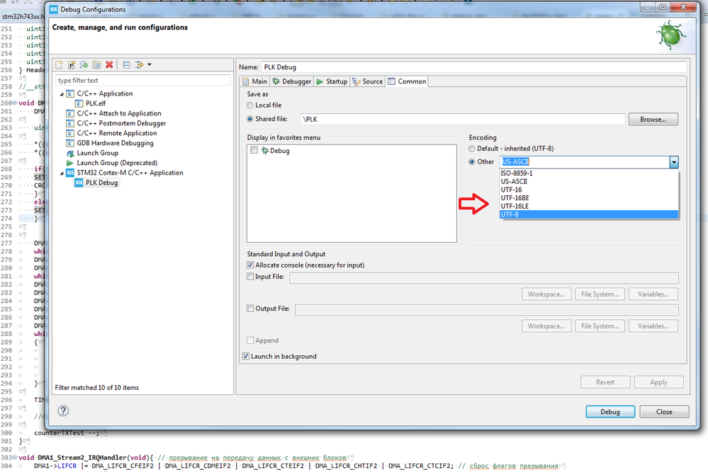

2020-12-24 8:31 PM
I didn't find cp866 in encoding settings.
What am I doing wrong?
2020-12-25 2:34 AM
For CP-866 use this encoding table: https://www.ascii-codes.com/cp866.html
Of course if you print that to a serial terminal or similar device it should be able to display it properly.
If the source text is in unicode (utf-8, utf-16...), convert it according to the table.
