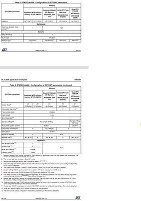

Hello @NajeebUllahKhan;

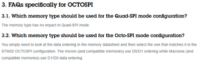

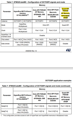

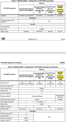

1- Are my configurations ok according to W25Q256JV?
To check your configuration, I recommend you to take a look at AN5050 Table 8. STM32CubeMX - Configuration of OCTOSPI parameters. This table explains how to configure the OCTOSPI parameter settings.
2- Memory Type is Micron or Macronix?
The memory type has no impact in Quad-SPI mode. So you can choose any memory type.
When using a octo-SPI mode, you simply need to look at the data ordering in the memory datasheet and then select the one that matches it in the STM32 OCTOSPI configuration. The micron (and compatible memories) use D0/D1 ordering while Macronix (and compatible memories) use D1/D0 data ordering.
Please take a look at this FAQ Overall FAQs for QUADSPI/OCTOSPI/HSPI/XSPI - STMicroelectronics Community
3- Device Size will be 23 or 24 as my flash is 32MB?
The size of the Quad memory in bytes and expressed in 2^n. The datasheet of the W25Q256JV is 256MBits = 32Mbytes = 0x200 0000. We see the bit 25 is set meaning 2^25 = 32 MBytes. In STM32CubeMx we set the Device Size field to 25.
I hope this answer your request.
Thank you.

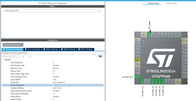

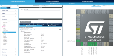

2025-04-22 4:10 AM
I am using Winbond W25Q256JV 32MB and STM32L562CEU6 UFQFPN48 which has OSPI with following options (Disable, Single SPI, Dual SPI, Quad SPI) and I selected Quad SPI.
I have attached my configuration below in picture from CubemX. I have some questions.
1) Are my configurations ok according to W25Q256JV?
2) Memory Type is Micron or Macronix?
3) Device Size will be 23 or 24 as my flash is 32MB?
2025-04-22 4:30 AM

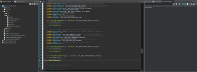

2025-04-27 11:33 PM - edited 2025-04-27 11:35 PM
Hi @KDJEM.1
I have W25Q256JV and STM32L562CEU6 with 38 Pin Package and have OSPI (Single SPI, Dual SPI and Quad SPI option only). Below is my Clock Settings, OSPI (Quad SPI) with Quad Lines Settings and Error Status during Write Enable and main.c file.
Kindly check and let me what is wrong so it's going into Error Handler every time on Write Enable.
If any basic drivers are available for OSPI in Quad Mode for Read/Write/Erase.
Looking forward to your kind help...

sCommand.DataDtrMode = HAL_OSPI_DATA_DTR_DISABLE;
sCommand.NbData = 1; // 1 byte to read from status register
sCommand.DummyCycles = 8;
ret = HAL_OSPI_Command(hospi, &sCommand, HAL_OSPI_TIMEOUT_DEFAULT_VALUE);
if (ret != HAL_OK) {
// Log the error here
Error_Handler();
ret = HAL_OSPI_AutoPolling(hospi, &sConfig, HAL_OSPI_TIMEOUT_DEFAULT_VALUE);
Error_Handler(); /* every time goes into error handler here */
/* Polling finished successfully */
