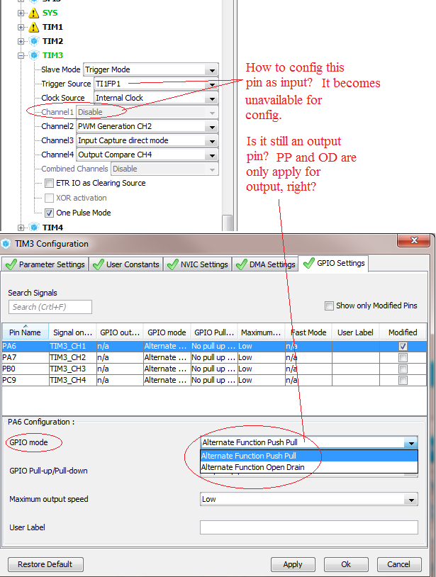

Does any body know why the input pin can not be driven high enough when it is set as the trigger to TIM3 in OPM? I use CubeMX to generate the init code where TIM3 ch1 as input trigger and ch2 as the output. On the board, I use a comparator to drive ch1 but it is going only 0.9v high! It can go 3.3v without driving ch1. Why? I need to fix it asap. Thanks!!!

How to varify the pin init? I use CubeMX which automatic create the code for me. Can you share some code other than MX? Thanks
I use STM32F303RE, TIM3 in OPM, PA6 in/PA7 out.
I forgot to mention that TIM3 ch3 and ch4 were also used for capture and output respectively for different purpose. Would it be related?

Hi, JW,
I am not sure and it is my concern that in CubeMX, it is still left as output since it became unavailable when TI1FP1 is select as input trigger. See the PIC.
I feel it is still an output pin since it could not be driven high.
Thanks

Read out and check the actual GPIO and TIM registers'content.
The mcu works out of the registers and does not care about what is ticked and clicked in CubeMX.
