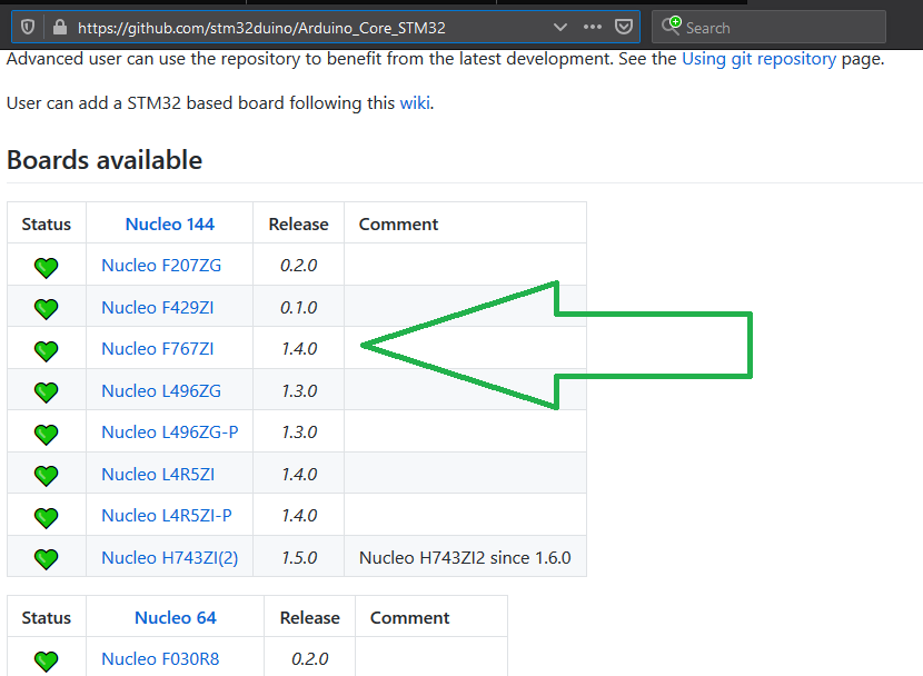

Another possibility is to use the Arduino IDE to program uC STM32, depending on the model it can be supported by the IDE, this helps a lot to quickly check for the presence of bugs in codes, whether in the Arduino IDE, or STM32.
https://github.com/stm32duino/Arduino_Core_STM32
