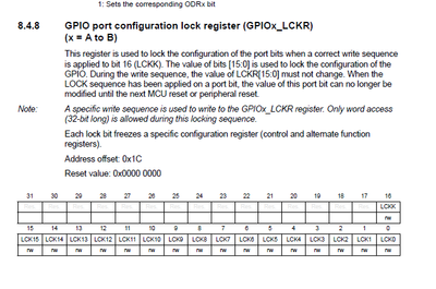

2024-11-21 11:48 AM
Hello @brat0x2 ,
You can do it with both ways, by Oring all pins or one by one, but better to lock them at once for performance reasons.
This is the register:
You can write all the bits at once (by oring).
See also this link. LL_GPIO_PIN_ALL value is the oring of all pins.
