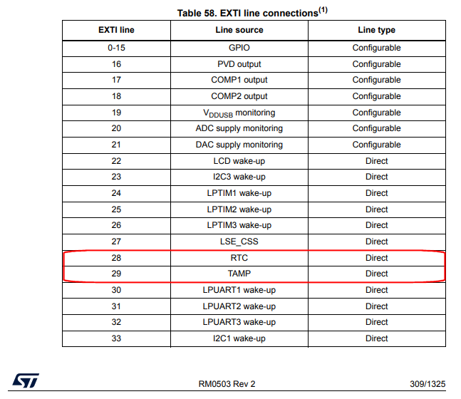

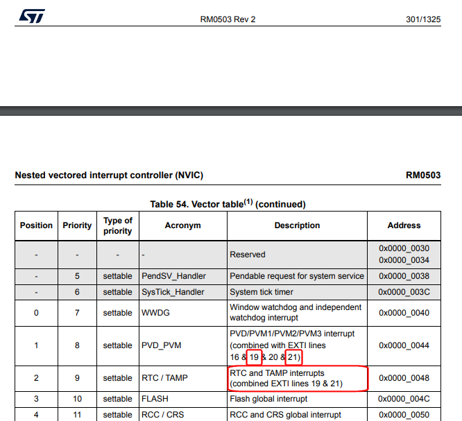

I'm a little bit confused by the NVIC and EXTI description in the RM0503.
The NVIC vector table says the RTC / TAMP interrupts are combined EXTI lines 19 & 21 (on page 302).
But when looking at the EXTI line connections table (on page 309) the RTC source is on line 28 and TAMP on line 29.

Hello @christian-enderle
Thank you so much for reporting this typo. I will escalate it for correction on the comming releases of the doc.
