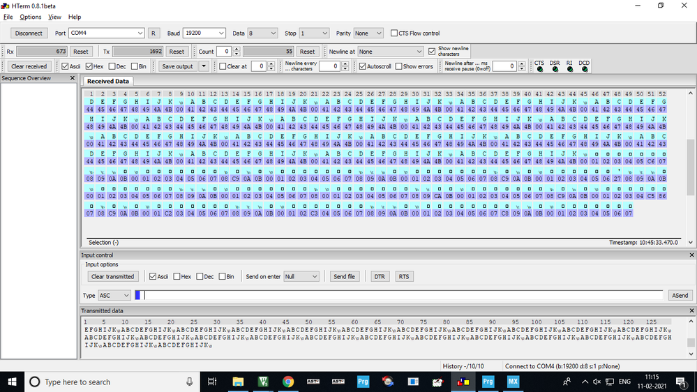

2021-02-12 11:10 PM
>>Buffer needs to hit full capacity before the callback will trigger, you use the same active buffer. - I am only receiving data till '\0' (NULL) is received. Therefore callback will be triggered once NULL is received, which is working as expected after programming using KEIL IDE. But after switching off the supply and restarting the device the receive interrupt is not working properly.
>>Inconsistent use of 80 / 100 lengths. rec_data should be volatile. - I changed both the values to 80 and made rec_data as volatile ,but it also did not work.
Please find the attached clock configuration.
