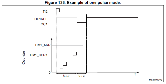

I'm using STM32F429x. I'm confused by the 'OCx fast' setting when using the 'One-pulse mode' of the timer. In DM00031020 section 17.3.15, it states:
In One-pulse mode, the edge detection on TIx input set the CEN bit which enables the
counter. Then the comparison between the counter and the compare value makes theoutput toggle. But several clock cycles are needed for these operations and it limits theminimum delay tDELAY min we can get.''But several clock cycles are needed for these operations...., it limits the minimum delay tDELAY min we can get'', I think it means if we don't enable OCx fast setting, we will get a delay. However, I don't understand where the delay will appear in the figure above?
Anyone can explain the situation more clearly? What we can benefit from enabling �OCx fast'????

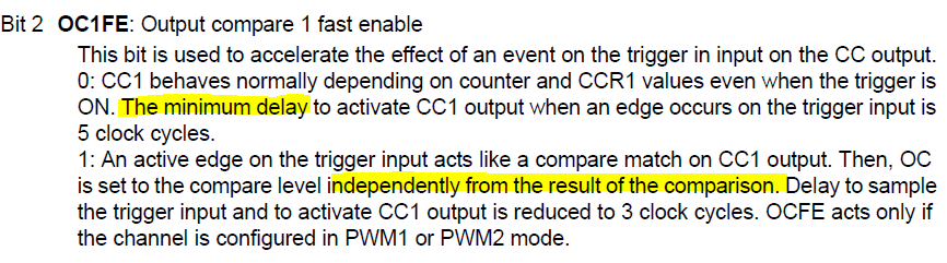

Here is the OCxFE flag

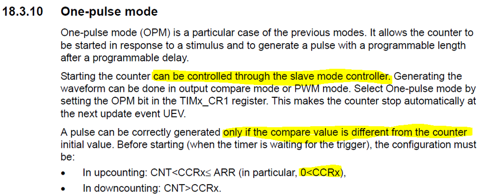

here is explained that the one pulse mode is part of slave functionality

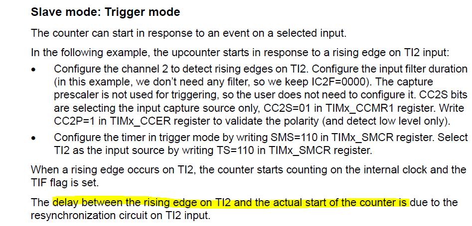

and here is explained that this delay is due to the resync cirquit(slave functionality)
An interpretation could be The minimum delay from trigger to output is 5 clocks from internal delay plus one counter period (PreSCaler involved)
So if you want to trigger a pulse ''right now'' in one pulse mode , you must wait 5clcks +1 counter period.
In this case you can minimize the delay by set the OCfast bit, to 3 clocks only. (and no one counter period )

I see. Thi is IMO confusion in terminology: One Pulse as feature set by TIMx_CR1.OPM, i.e. automatic CEN clear upon update (which is independent on OCxM settings); versus 'I want to see one pulse on the output'.
