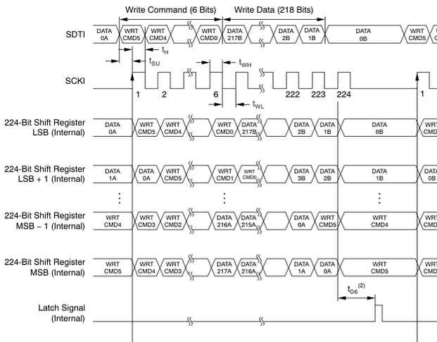

Without latching, send a bunch of data, like 2x224 bits or more. Observe the data on SDTO with a LA and compare whether they match the input delayed by 224 clocks.

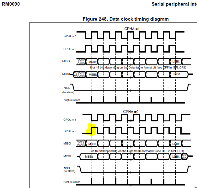

hello!
>>>> SPI : ( slow baud rate; 125Kbits/s; CPOL Polarity Low; Phase CPHA: 1 Edge)
TLC5971 manual
RM for MCU
so CPHA must be 0
>>>> HAL_GPIO_WritePin(MCU_SCKI_GPIO_Port,MCU_SCKI_Pin,GPIO_PIN_SET); /// I set the SCKI High so
/external-link.jspa?url=http%3A%2F%2Fwww.ti.com%2Fproduct%2FTLC5971
creates the latch and register.Is your intention to use a GPIO set function when your pin is configured allready as AF (SPI SCK)?
Actualy there is no need to pull SCKat HI state.
The above figure from TLC5971 manual, shows to keep the SCK at low state for a tD6 time. (introduce some delay tD6 after finish transmission)
Note : with CPOL =0 , the SCK polarity after finish the transmission, is allready low.
Regards

2017-09-01 3:15 AM
Hi Vangelis!
I use
Phase CPHA: 1 Edge; which means CPHA=0;
Maybe I'm wrong, but usually 1 Edge -> CPHA= 0
2 Edges -> CPHA =1
Best Regards
2017-09-01 4:40 AM
Hi again.
I wrote ' so CPHA must be 0' You use CPHA=1. I do not agree
In all cases you must double check everything. From power supplies to the consisteny of data you send.
