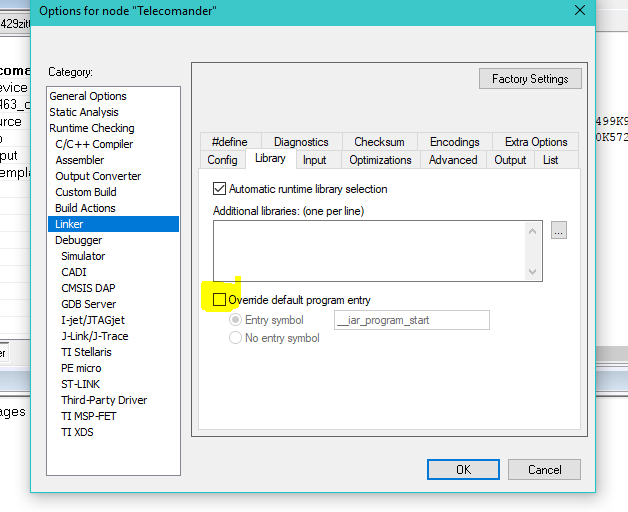

Hello!
This call to __iar_program_start is for initialize the C runtime libraries used by IAR and needed for program . This function contained in a library.
After initialization   calls the main function.
You can bypass this function by specifying your own entry symbol. like the picture
SystemInit is the function inside system_stm32xxx.c responsible to initialize the clocks etc

As the name suggests, it is IAR specific.
You can check your project for linked libs, and scan them.
Or check the documentation/tutorials.
Or, finally ask IAR ...
