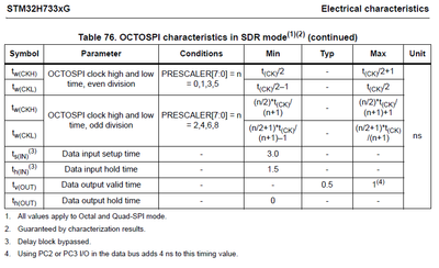

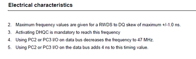

I have checked RM0468 but I can’t find anything explicitly stating that PC2_C/PC3_C could not be used for high speed communication.
2024-08-13 3:41 AM
Check the datasheet not the RM, search for "PC2".
Datasheet of H733, should be the same for H723/H725.
See note 4.
Even worse, see again note 4 for HyperBus, max freq with PC2 is 47 MHz:
Dear ST, this should not be in smallest print in some footnotes, but bold and BIG in each mentioning of every use outside of analog input.
There was no CubeMX warning?
