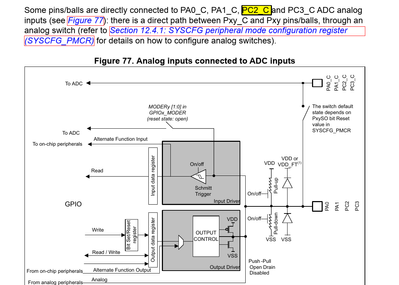

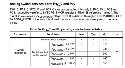

>Yes I am using PC2_C and PC3_C - is there something I must take into consideration?
YES. The xx_C are not good to drive hi-speed signals :
ds:
So you have about 400 ohms source resistance here +
xx_C should be used only for ADC input ...
and should not drive more > 1mA , otherwise you might kill it . (I did - so i know - with just the clock to a TFT on a xx_C pin. Testing TFT with 4MHz clock was ok, but then i switched to 16MHz - 1 screen written, then pin died. )
So dont use these pins for hi-speed signals - they cannot drive it. If you cannot change it now, try with
ed : low speed setting (400 ohm in series ! ) , just to verify your design is working. (maybe 2 MHz clock...)
