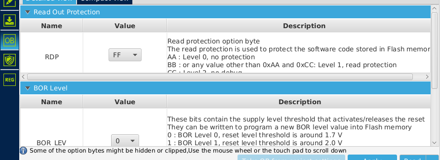

To protect the device's software, I am updating the RDP values in my own bootloader software, and to protect it in the event of a sudden power outage, I am also updating the BOR values. I am performing these updates only using HAL APIs. Additionally, I am writing the option bytes one by one. During development and testing, this worked flawlessly. However, the device has now entered serial production, and we are programming in large quantities. So far, 200 MCUs have been programmed, and approximately 50 of them ended up with an RDP value of 0xFF and the BOR value not set. I urgently need assistance regarding this issue. Production has been halted and is waiting for this problem to be resolved. Please help me.

2025-09-11 6:07 AM
RDP value of 0xFF indicates the option byte process was interrupted (potentially due to loss of power) and perhaps the option bytes contain invalid data. The complementary option bytes must be consistent.
I recommend initializing ob_init with exactly and only what you want to modify. Take a look at HAL_FLASHEx_OBProgram to see what it needs to modify those two values.
