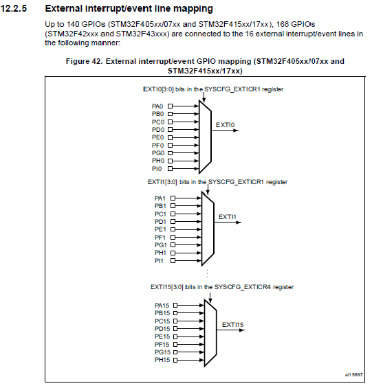

Is it possible to link same pin number of different GPIO ports on the same EXTI line ? For example, create an interrupt on line_0 for the GPIO pin A0 and the pin B0. It seems impossible to achieve with the ST librairies - but I don't understand why it's impossible regarding to the internal schematic of the STM32F4... I really want to use more than 16 GPIO with interrupts. Is there a software way to perform this interruption ?Thanks a lot !2013-09-19 9:33 AM

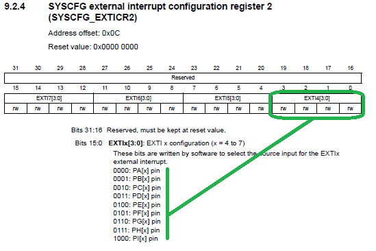

NO, it uses an N-to-1 mux, only one bank's pin reaches the signal conditioning.

Generally you'd use an external priority decoder to decimate the number of pins required on the CPU.
Alternatively you could use TIMx_CHx pins in input capture mode, or poll slow GPIO sources. I'd recommend a print out of the Data Sheet with pin designations, and a high-lighter pen. Assign the TIM pins first, then the EXTI. Draw a pin vs bank matrix if that helps.2013-09-20 12:09 AM
