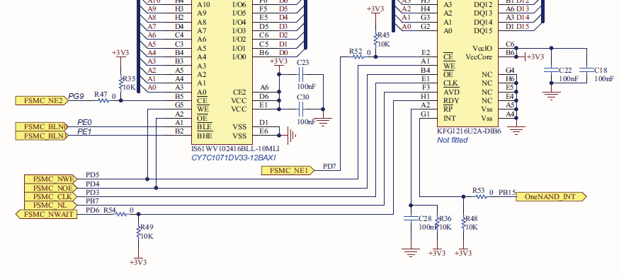

which one is R/B ?
I don't have PG6, could it be PD6 ? what's PG6 for then ?? I attached the schematic and Nand Flash chip datasheet, what do you reckon ? thanks

2014-03-27 5:49 AM
FFS it's the WAIT pin, in this case a GPIO Input on PD6, providing a BUSY (B) or READY (R) signal. It's presumably a GPIO because the signal is not sufficiently compatible with the FSMC, or that's it's not appropriate to stall the CPU waiting for a slow memory device.
The interrupt mode would only be appropriate if you have some stateful implementation2014-03-27 5:59 AM

am I defining the pin on code into the board correctly ? Please have a look on the code :
/* CLE, ALE, D0->D3, NOE, NWE and NCE2 NAND pin configuration */
GPIO_InitStructure.GPIO_Pin = GPIO_Pin_11 | GPIO_Pin_12 | GPIO_Pin_14 | GPIO_Pin_15 |
GPIO_Pin_0 | GPIO_Pin_1 | GPIO_Pin_4 | GPIO_Pin_5 |
GPIO_Pin_7;
GPIO_InitStructure.GPIO_Speed = GPIO_Speed_50MHz;
GPIO_InitStructure.GPIO_Mode = GPIO_Mode_AF_PP;
GPIO_Init(GPIOD, &GPIO_InitStructure);
CLE = PD11
ALE = PD12
D0 = PD14
D1 = PD15
D2 = PD0
D3 = PD1
NOE = PD4 = RE ? <==On NAND Flash board
NWE = PD5 = WE ? <==On NAND Flash board
NCE2= PD7 = CE ? <==On NAND Flash board
/* D4->D7 NAND pin configuration */
GPIO_InitStructure.GPIO_Pin = GPIO_Pin_7 | GPIO_Pin_8 | GPIO_Pin_9 | GPIO_Pin_10;
GPIO_Init(GPIOE, &GPIO_InitStructure);
/* NWAIT NAND pin configuration */
GPIO_InitStructure.GPIO_Pin = GPIO_Pin_6;
GPIO_InitStructure.GPIO_Mode = GPIO_Mode_IPU;
D4 = PD7
D5 = PD8
D6 = PD9
D7 = PD10
NWAIT = PD6 = R_B ? <==On NAND Flash board
